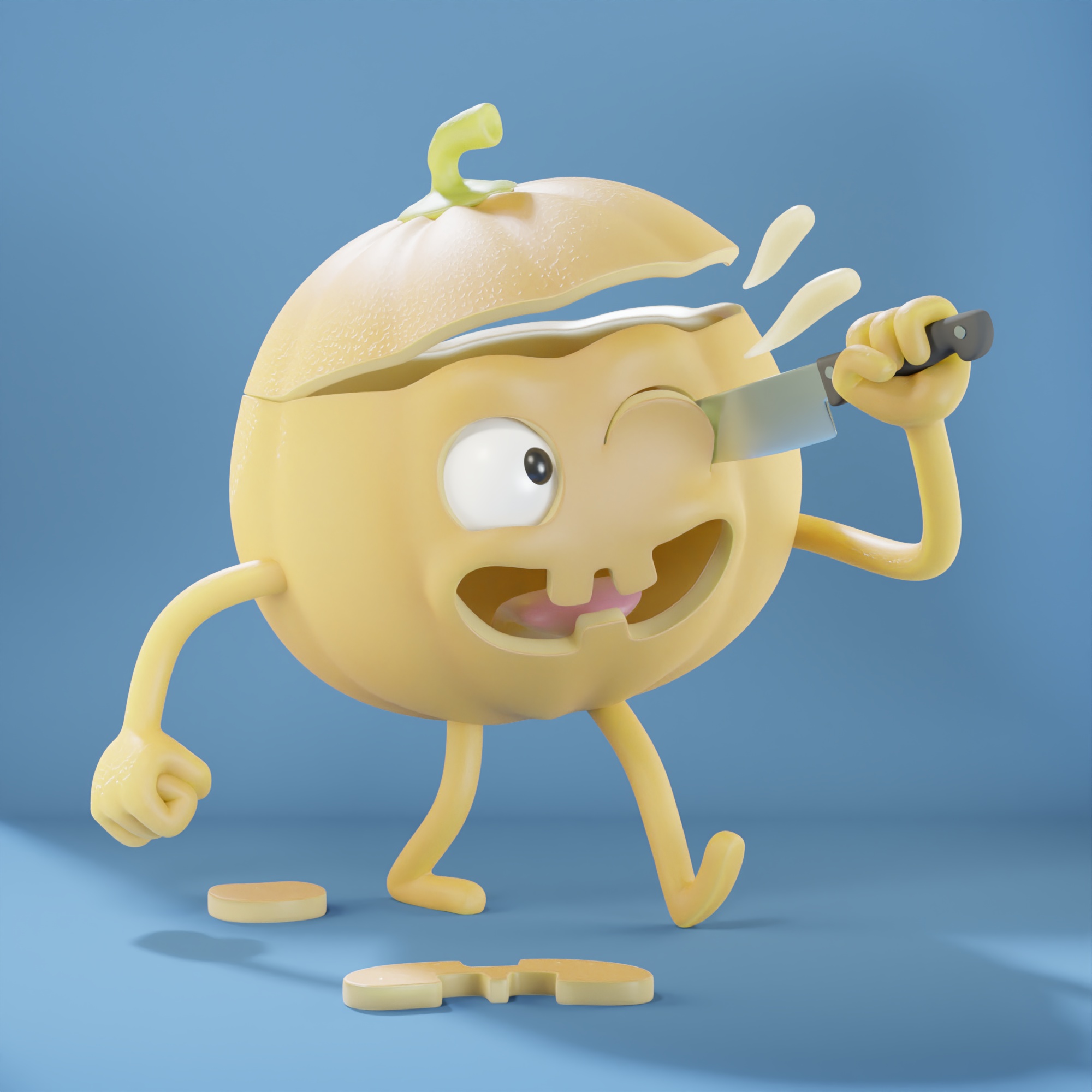

OK, tried to match the advice in the Luxcore Wiki SSS page some more, but when I leave both the Glossy Translucent material's Transmission color and the Volume's Scattering value white, colors become very faint, and the bump map starts looking like artifacts:
Darkening the Diffuse and Absorption colors also doesn't work out. And no matter what I do, changing materials, volumes and light strengths, I can't get the glowy light depth like in Cycles, as if Cycles has a different Random Walk implementation than Luxcore.
Concluding after all my attempts, I think Luxcore SSS is too hard to control compared to Cycles. I think that's a pity, as SSS is an important factor to create lively materials for characters. In just about every other aspect I like Luxcore's results better: overall shading, light response on surfaces, shadow crispness and more.
