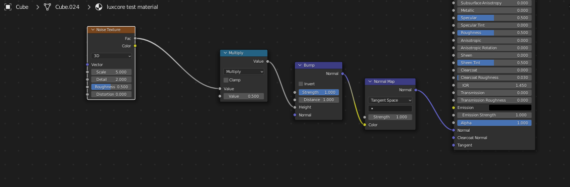

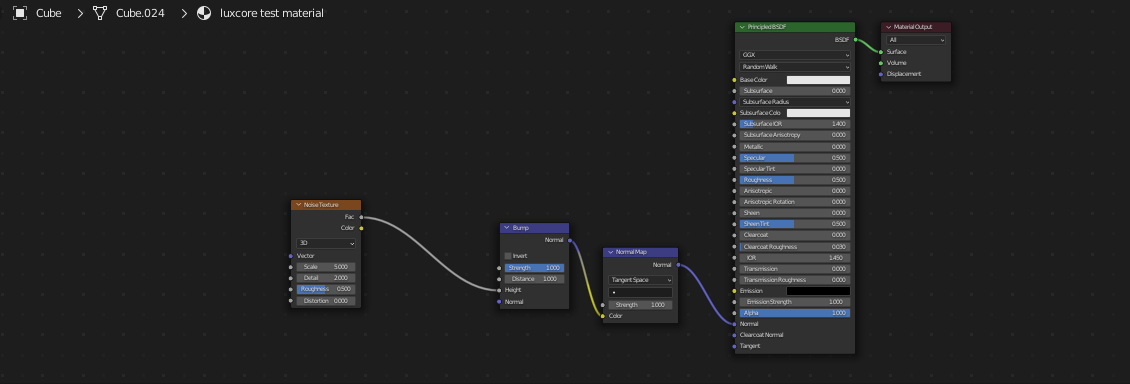

Trying luxcore for the first time in Blender 3 and half of my Cycles materials kept crashing Blender whenever I checked "use cycles nodes" in the materials tab if I was in rendered/preview mode, or after I switched into rendered/preview mode with the option checked. Tried to find what it is and it seems to be the Math node, at least in some cases.
Is this a bug or is it just an unimplemented feature?
Using Blender 3.0.0 with latest Luxcore 2.61 addon on Windows 10.
This material works fine:

This crashes Blender:
