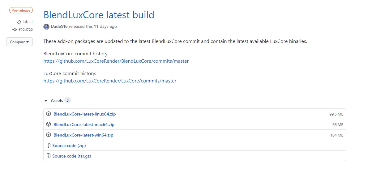

If you have the CUDA backend selected, there should be an OptiX option. If it's not there, you might not have a correct 2.5 installation? Try to delete the whole addon folder and do a fresh install of the daily build.
The user preferences should look like this:
