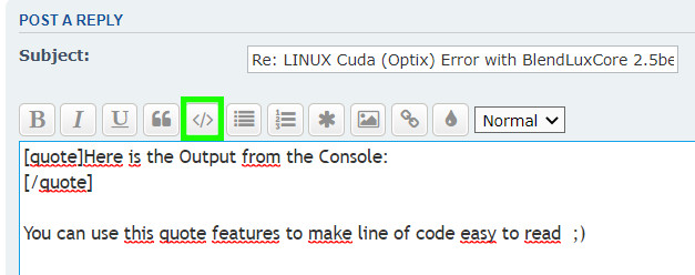

You can use this quote features to make line of code easy to readHere is the Output from the Console:

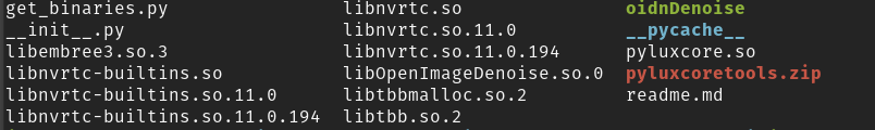

The problem is here:
Can you post here the list of files in your "/home/xxxx/.config/blender/2.92/scripts/addons/BlendLuxCore/bin" directory ?
Check your "/home/xxxx/.config/blender/2.92/scripts/addons/BlendLuxCore/bin" directory, you should have there a "libnvrtc.so" and "libnvrtc-builtins.so" files.johannes.wilde wrote: ↑Tue Jan 12, 2021 1:38 pm [LuxRays][18.592] [MergeSampleBuffersOCL] Compiling kernels

The files seem to in place. Is it relevant, that i don't use a installed version of Blender but a daily build?
Thanks for your help!
