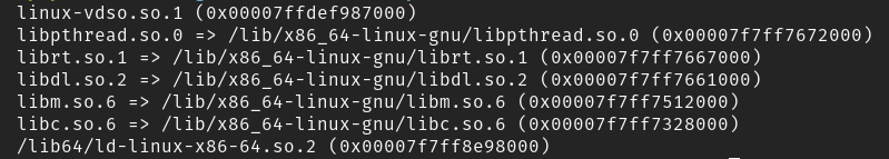

Check your "/home/xxxx/.config/blender/2.92/scripts/addons/BlendLuxCore/bin" directory, you should have there a "libnvrtc.so" and "libnvrtc-builtins.so" files.

It is hard to say. One reason could be you have another "libnvrtc.so" installed on your PC and it is loaded instead of the one in the bin directory. Another possibility is that .so are not loaded because the fail of some other dependecy.
Can you try to go in bin directory and run the following commands:
ldd libnvrtc.so
and post here the output. It will show how/where the .so dependencies are resolved.

Here is the output from
ldd libnvrtc.so in ./bin
On Blender 2.83 Optix isn't working at all. It fails in Cycles as well.
On Blender 2.91 Cycles runs with Optix, but in Luxcore i get the same Error.
