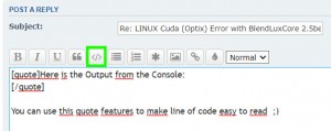

You can use this quote features to make line of code easy to readHere is the Output from the Console:
