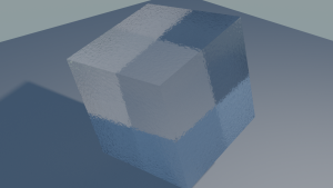

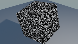

Below is a cube with 2m diameter with an fBM texture as bumpmap.
sampling distance = 0.001

sampling distance = 0.000001

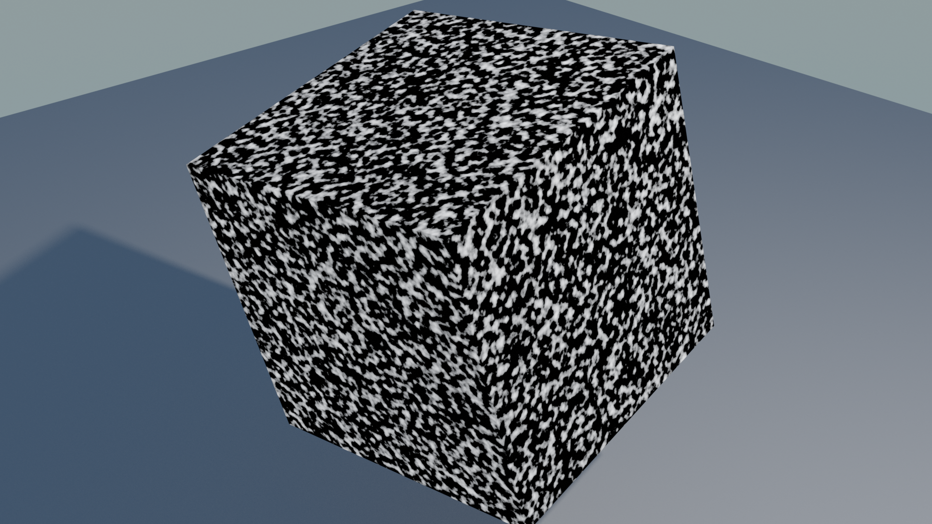

the bumpmap as black/white values (note negative values are clamped to black)

B.Y.O.B. wrote: Fri Nov 20, 2020 2:45 pm In my tests it seems like just using a lower default value in all cases could be a solution.
But I guess the default was chosen higher for a reason, so could it introduce problems I don't notice now?
If the sampling distance is too small compared to the wave length of the procedural textures, you can start to have a delta, between two sampled points, equal to 0.0 and non bump mapping at all. It can not happen with real numbers but it can happen with FP32. You can also experience aliasing problems if the sampling distance is not appropriate.
Whatever default value you pick, I can always build a scene where it will show problems.
May by you can have combo with 3-4 preset values: micro details (0.00001, the default setting), small details (0.001), macro details (0.1), user defined (i.e. the number is set by the user). Like I said there always can be a case outside the intended range.

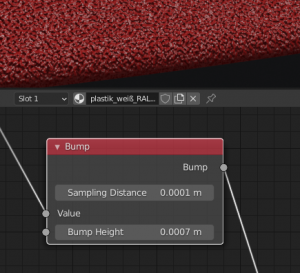

Re: Where the bump gets strange
Ok, I have added the "Sampling Distance" parameter to the bump node.
The tooltip description is
Distance to use when picking two points on the surface for bump gradient calculation.
Use smaller values if procedural bump textures with very fine details don't show a bump effect.
Note: does not affect bump sampling of image textures.
