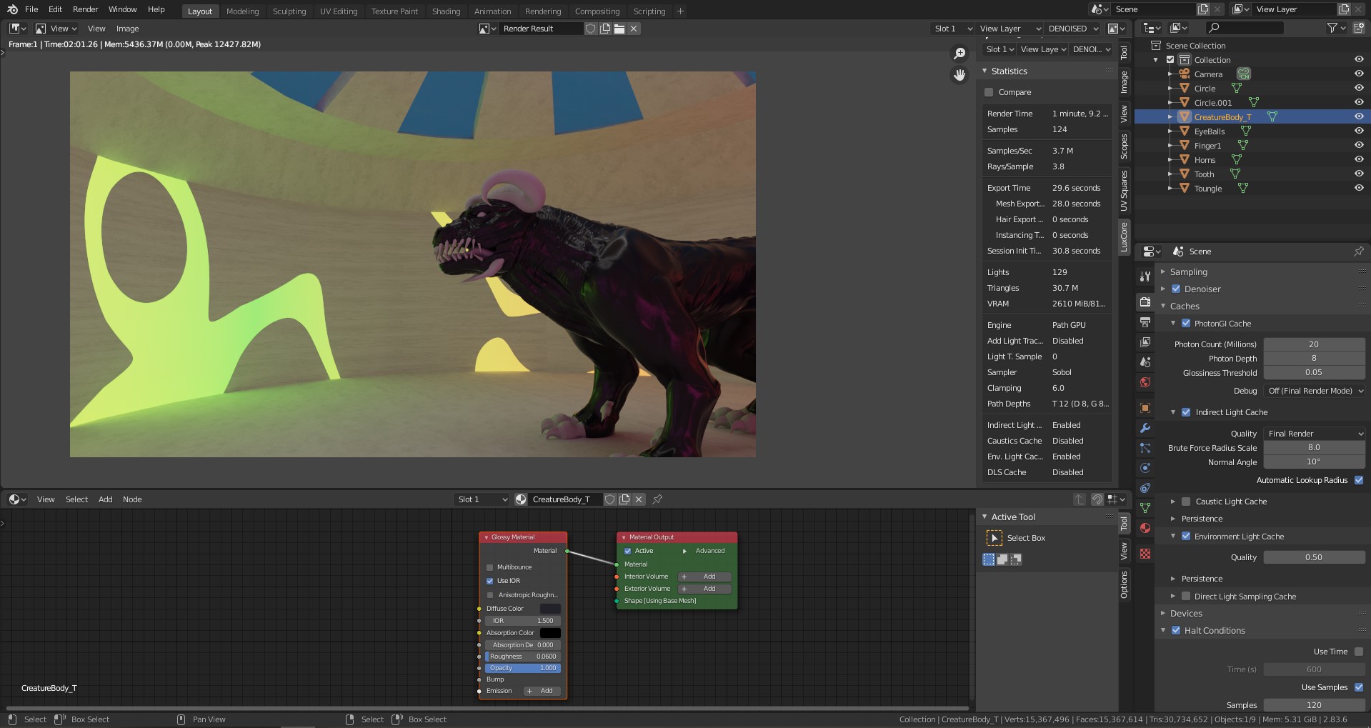

Also, I made simple scene. It contains about 15M points, and two variants with and without cashes. I render it with RTX 2080 + CPU

DionXein wrote: Sat Oct 24, 2020 7:08 am Also, I made simple scene. It contains about 15M points, and two variants with and without cashes. I render it with RTX 2080 + CPU
Yeah caches definitely speed up the render, but that won't work for my project.
