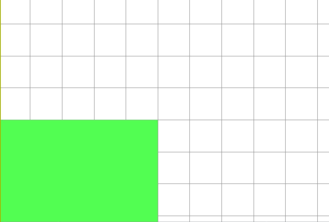

Okay, not familiar with the blender api, just figured out that the Lens value comes from blender. So I am guessing blender is calculating the camera render region automatically. So dived into the Luxcore C++ code, and found this. I believe I am close. I also calculate the perspective matrix and multiply it by the camera world transform. But I am missing a step?
// identity matrix.
if (orig == target)
	trans->cameraToWorld = Transform();
else {
	const Transform worldToCamera = LookAt(orig, target, up);
	trans->cameraToWorld = Inverse(worldToCamera);
// Compute projective camera transformations
trans->screenToCamera = Inverse(Perspective(fieldOfView, clipHither, clipYon));
trans->screenToWorld = trans->cameraToWorld * trans->screenToCamera;
// Compute projective camera screen transformations
trans->rasterToScreen = luxrays::Translate(Vector(screenWindow[0] + screenOffsetX, screenWindow[3] + screenOffsetY, 0.f)) *
	Scale(screenWindow[1] - screenWindow[0], screenWindow[2] - screenWindow[3], 1.f) *
	Scale(1.f / filmWidth, 1.f / filmHeight, 1.f);
trans->rasterToCamera = trans->screenToCamera * trans->rasterToScreen;
trans->rasterToWorld = trans->screenToWorld * trans->rasterToScreen;
And an image to show the problem. I could live without this, since there's interactive rendering but would love to get it to work.

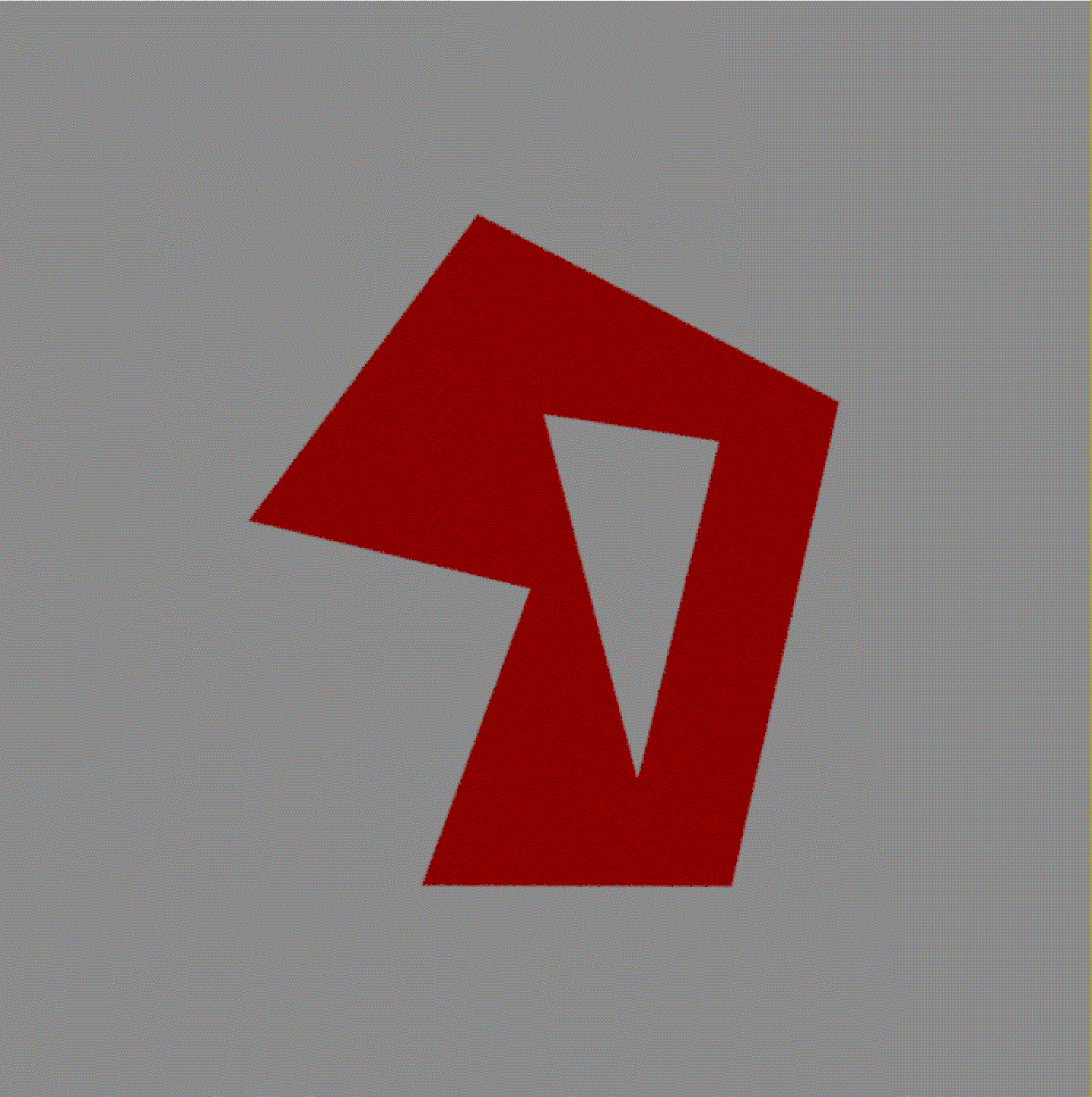

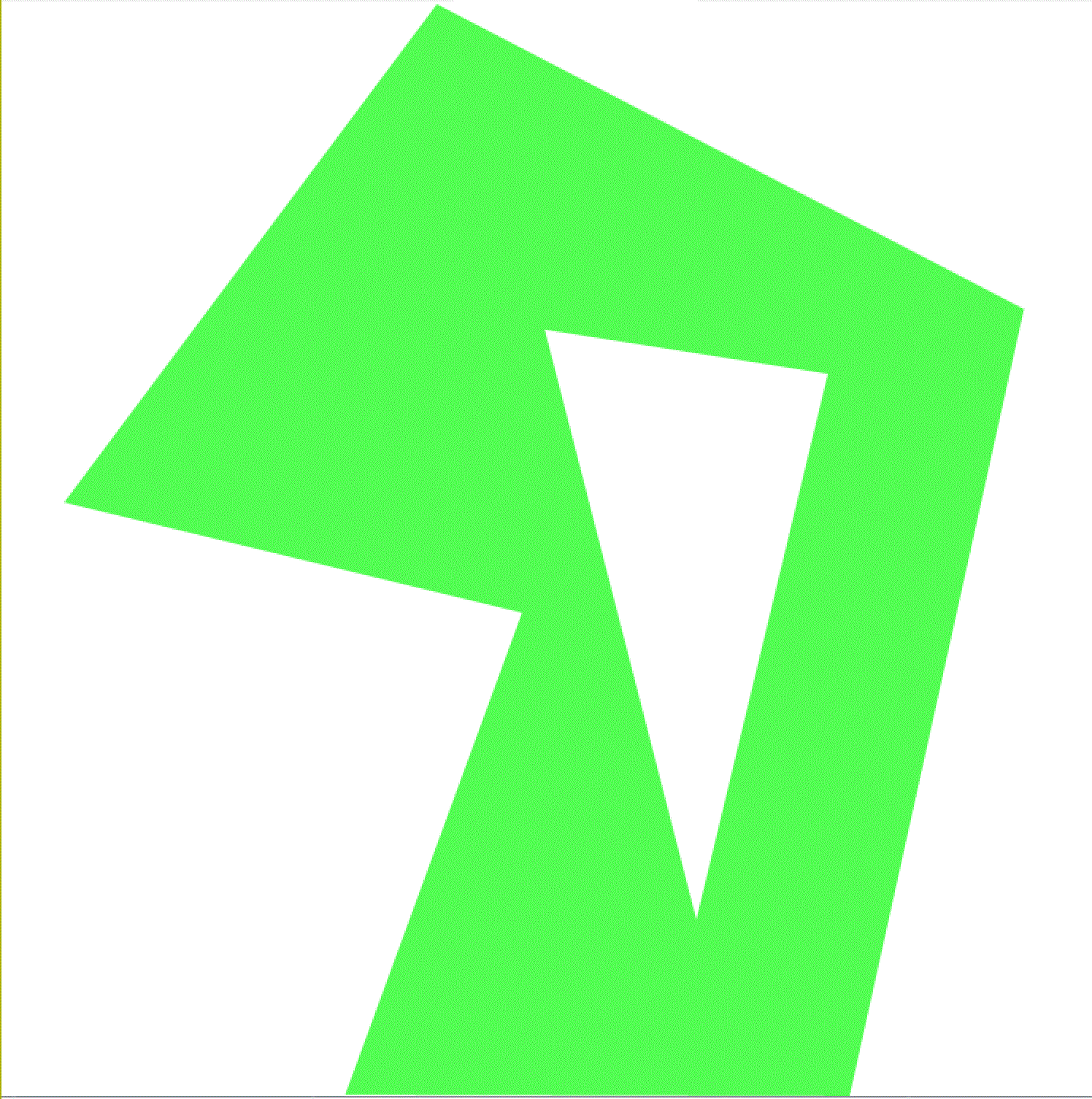

Post by Ernest » Sun Nov 15, 2020 6:27 pm
This is meant by symmetric view:
and this by asymmetric - camera placement is unchanged in the following image just screenwindow has changed (by using something like a magnifying glass to view a sub-section)
Even if the screenwindow values are symmetric (e.g -xstart == xend) and xstart == ystart original image and lux image do not fit
Source image:
Luxcore image - please ignore the colors - WIP.:
Stepping through Lux source seems to show that the rasterToScreen matrix works as expected. The screenToCamera part is harder to check.
How to calculate the FOV value for a symmetric squared case seemed obvious to me: 2 * RadToDeg(atan(yend - ystart)/2/FocalDistance)) .
But how is it supposed to work for the general case?
This explains hopefully a bit better what I do not understand.
