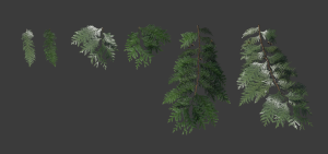

Re: TwoSided material
Post by CEROE »
There are a couple issues:
The backside seems to be extra glossy. I have tried the same settings for each, and the backside is different.
When mirroring a twig the faces are also switching.
The glossy material has a weird legacy behaviour, see https://github.com/LuxCoreRender/LuxCore/issues/301
