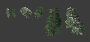

Post by CEROE » Thu Sep 17, 2020 2:19 am
There are a couple issues:
The backside seems to be extra glossy. I have tried the same settings for each, and the backside is different.
When mirroring a twig the faces are also switching.
