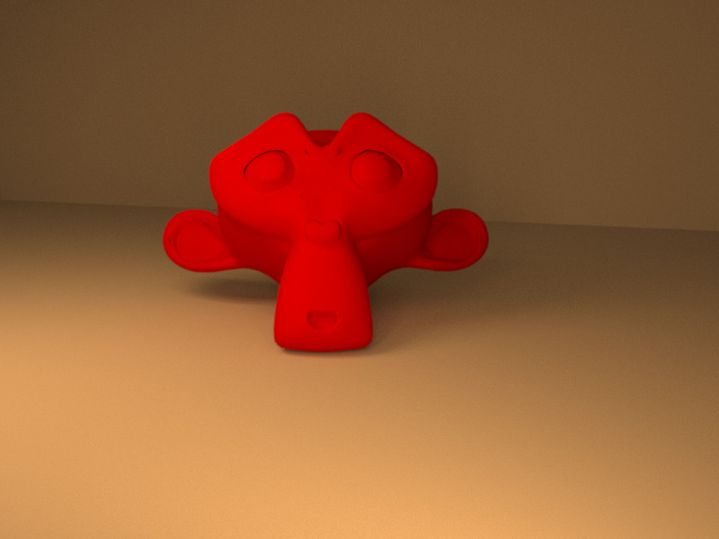

This is a rendering with black body 3000K and white balance 6500K:

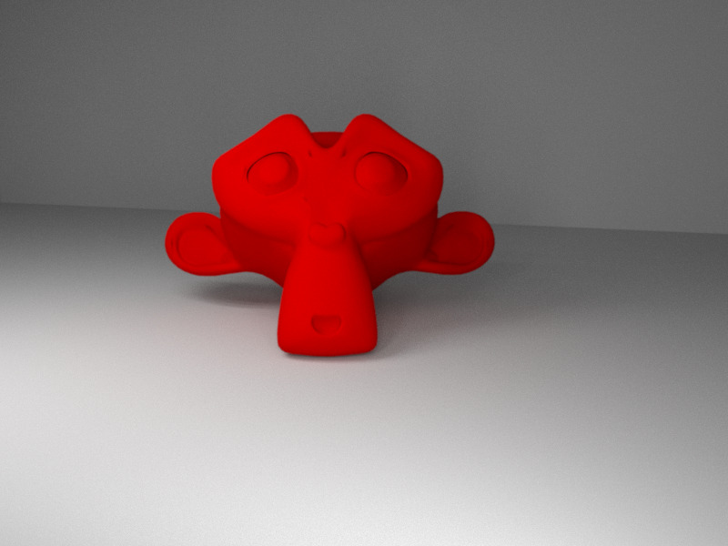

and it is "warm" as expected. This is a rendering with black body 3000K and white balance 3000K:
and it is "neutral" as expected. This is a rendering with black body 6500K and white balance 3000K:

the light (with power mode) and the cam is set like this and I get correctly this yellowish render
