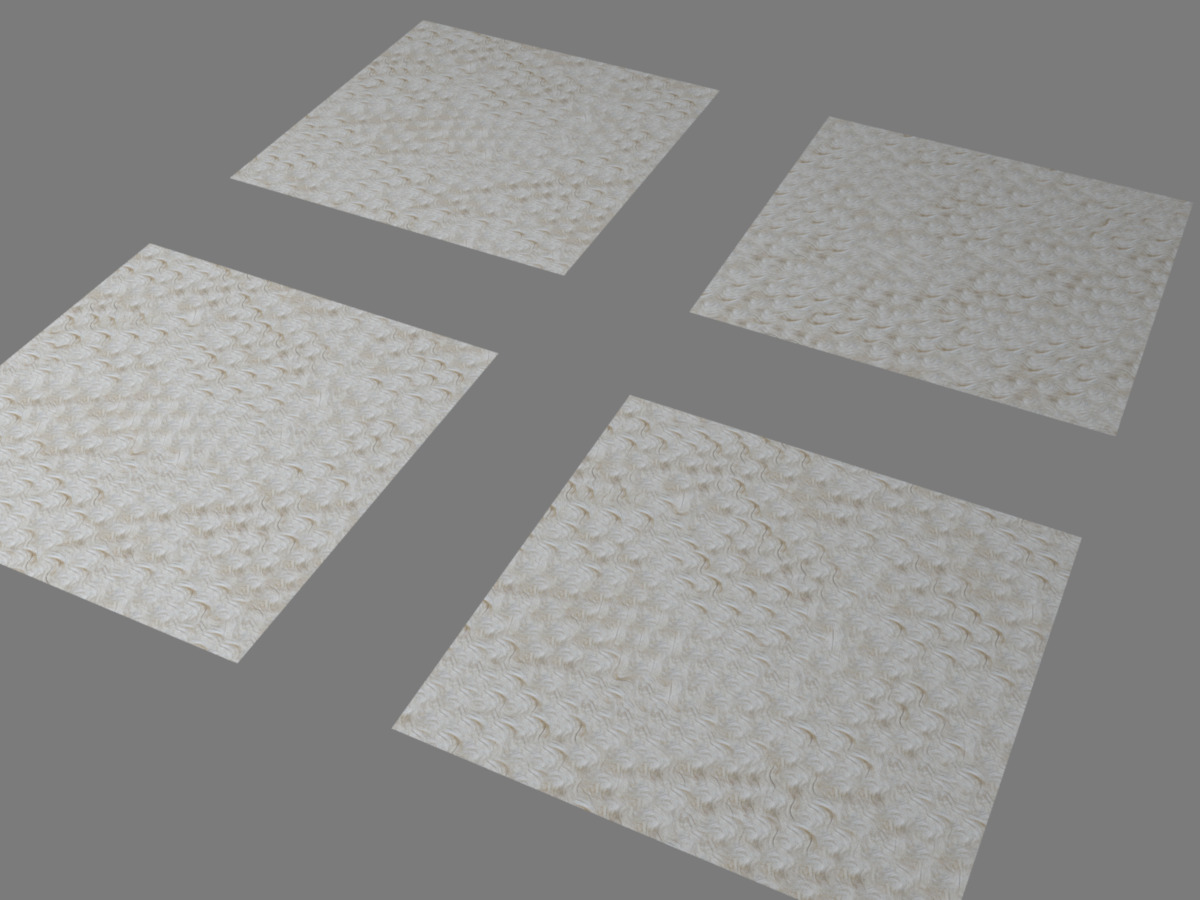

UVRandomMapping2D is a special kind of texture mapping 2D intended to randomize the UV mapping across multiple objects or the "islands" (by using the IslandAOVShape) of the same object.
This is normal mapping+normal tiling:
This is normal mapping+random tiling:
And this is random mapping+random tiling:
