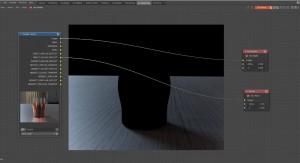

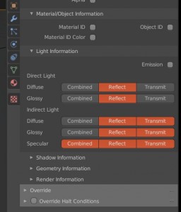

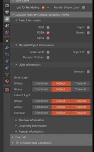

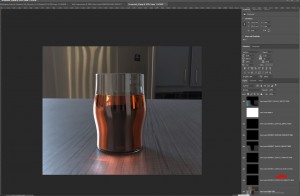

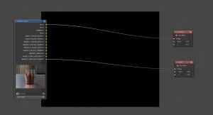

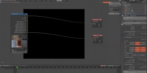

Hello Dade. How are you? I can't see my "Indirect Specular Transmit" and other AOVs passes. It appearing all black. I'd tested with Blender 2.82a and 2.90 with Luxcore 2.5 Alpha version - and in both versions it's the same issue. How can I render or see this "Refraction"(Indirect Specular Transmit) pass. There's something wrong here. Follow images to see what's happening. Thanks a lot!

@B.Y.O.B.: this looks like a BlendLuxCore bug, the SPECULAR Reflect/Transmit AOVs seems to do nothing. DIFFUSE/GLOSSY Reflect/Transmit buttons works while nothing change in the configuration for SPECULAR Reflect/Transmit buttons.
