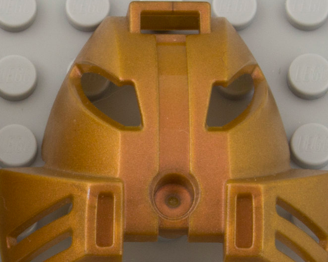

Alright, this is more for those specialty materials that were found only in Bionicle sets. These were quasi-metallic -- more of just the regular AB plastic with a metallic paint applied, but I found a few that have more than one color in their reflections, so-called "flip flop" colors. Is there a way to have a material change color based on viewing angle or so I have to settle with a close guess?
One such example, pulled from Ryan Howerter's Flickr feed (a great resource for those who are also interested in this, check it out ) In Cycles this could be done using the Fresnel node as the mix factor for combining two materials, but idk if Luxcore has a similar function (planned or otherwise)

Re: Trying to nail down the LEGO material
Try to experiment with absorption color in luxcore shader node. It can change color depending of the view angle. i use this effect for my carpaint tut here :
https://youtu.be/KFbk_JxPUj4
That did the trick. Thanks, Sharly! That just earned you another like on that vidSharlybg wrote: ↑Sun Jul 05, 2020 5:43 pm Try to experiment with absorption color in luxcore shader node. It can change color depending of the view angle. i use this effect for my carpaint tut here :
Happy that it help youThat did the trick. Thanks, Sharly! That just earned you another like on that vid
