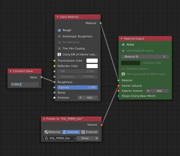

Hello all,
what happens if I reduce the roughness value (limit with direct entry is 0,001) with the help of an value node?
Is it possible to reach lower roughness values with this trick?
Thank you.

lighting_freak wrote:
Thu Jun 25, 2020 9:24 am
It is limited by the code to 1e-9: https://github.com/LuxCoreRender/LuxCor ... y2.cpp#L76
You can export the scene in text format to check how your node setup is exported.

Dade wrote:
Thu Jun 25, 2020 9:53 am
Should I use 1e-9 in the Blender addon as well?

B.Y.O.B. wrote:
Thu Jun 25, 2020 10:52 am
I don't think so, 1e-9 is a limit coming from old Lux and it is too small: if you check few line after, there is a square of the number (and than a division too) and it is very likely to end as a 0 with FP32. Using so small numbers is asking for troubles.
