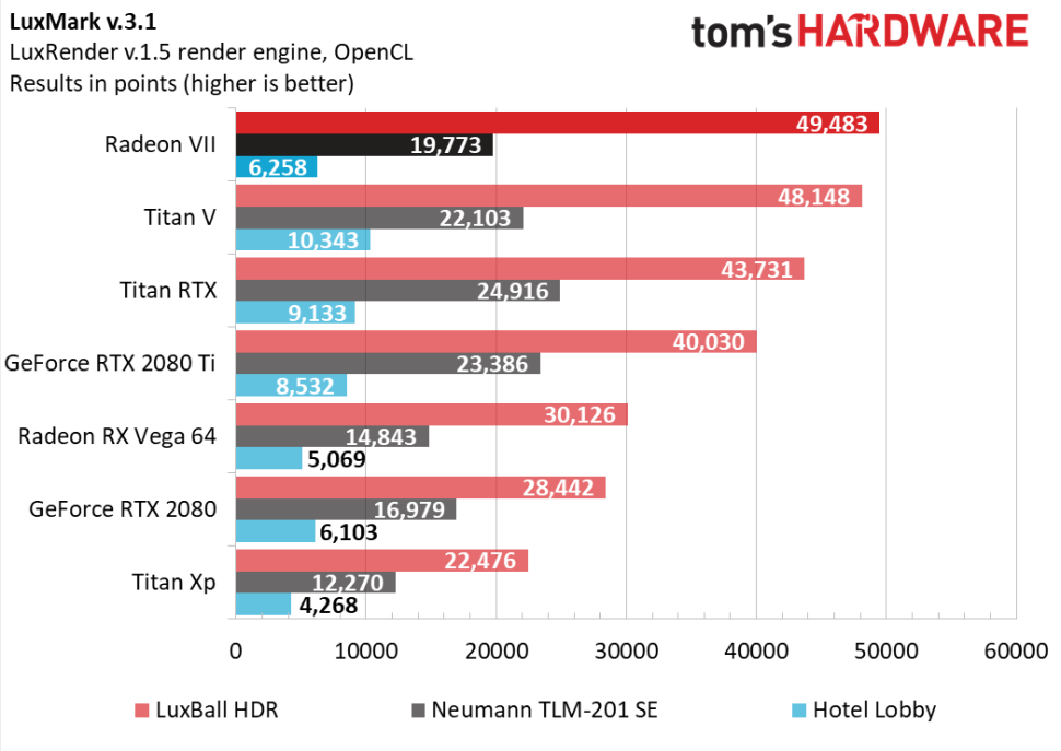

According to Tom's Hardware RX Vega 64 outperforms slightly 2080 but it is seriously behind 2080TI.

Storen wrote: Sun Jun 07, 2020 9:33 pm According to Tom's Hardware RX Vega 64 outperforms slightly 2080 but it is seriously behind 2080TI.
Radeon VII is still a Vega GPU (Vega 20), RX Vega 64 should be a "Vega 10 XT" GPU. As far as I remember, "Vega 20" was manufactured on a better fabrication node than "Vega 10 XT" but is pretty much the same architecture. Wiki seems to confirm what I remember: https://en.wikipedia.org/wiki/Radeon_RX ... e_graphics
