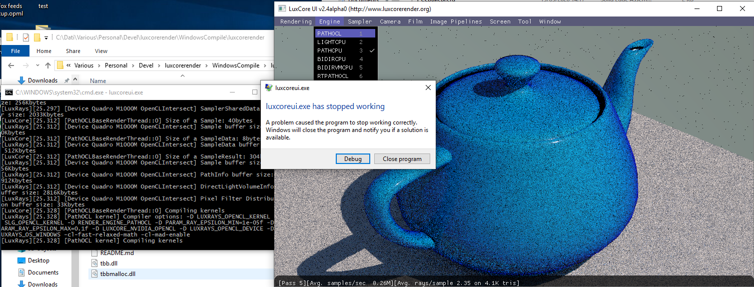

Quick test on Windows (LuxcoreUI only): CUDA ok, OpenCL crashes while compiling kernels:
I cannot investigate further at the moment, will try later.
Looking at the new sources, I thought it was wrong to have LUXRAYS_DISABLE_OPENCL defined, but even without it, it crashes.
A stack overflow happens in line 310, ocl.cpp:
Exception thrown at 0x00007FF6FD6AA6A8 in luxcoreui.exe: 0xC00000FD: Stack overflow (parameters: 0x0000000000000001, 0x000000E2BC623000).
Unhandled exception at 0x00007FF6FD6AA6A8 in luxcoreui.exe: 0xC00000FD: Stack overflow (parameters: 0x0000000000000001, 0x000000E2BC623000).
