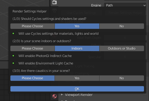

I have added an interactive render settings guide.
It asks a view questions and assings render settings based on the answers.
It is meant for newer users, to show which render settings are a good idea in which scene types.
Feedback and ideas welcome.
