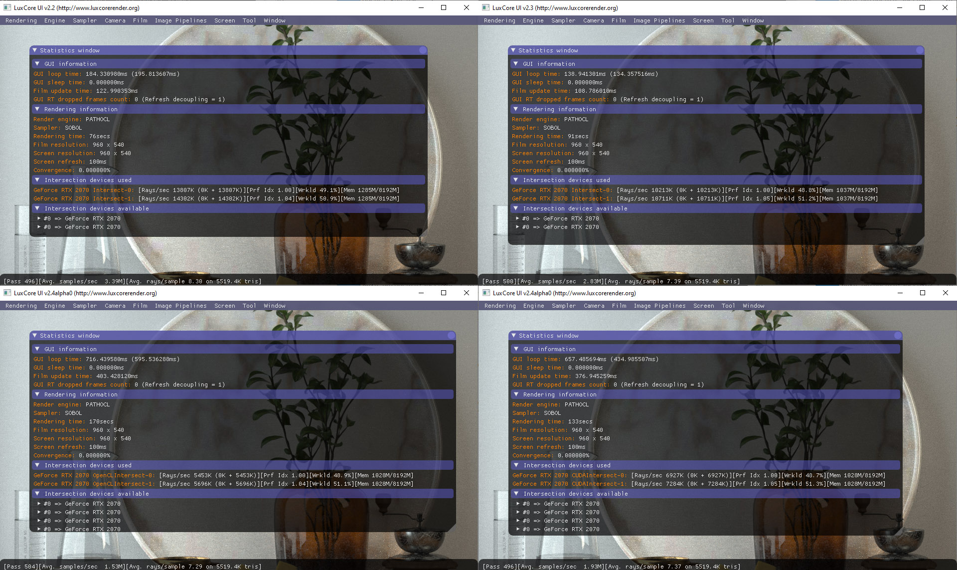

OMG I forgot to compare against v2.1!!
It renders even faster than v2.2 :shock: :o
But only a little bit :D :lol:
Rendered with no PGI (didn't exist in v2.1).
Now I dare not to try v2.0 . . .
