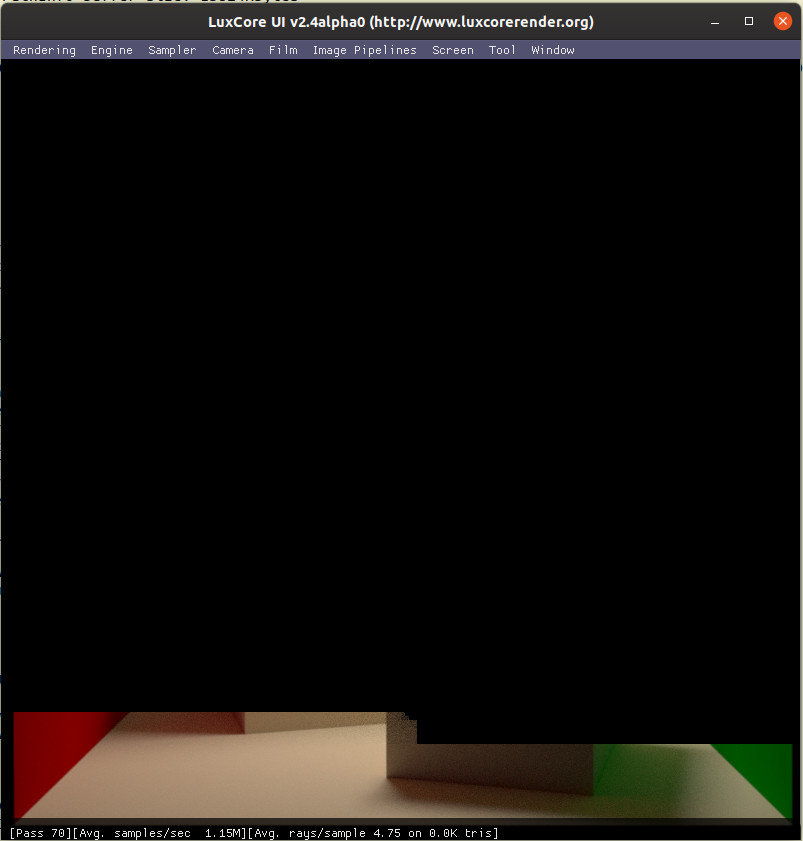

juangea wrote: Mon Apr 27, 2020 10:57 am My feeling is that it's also a bit faster in lux, and the progressive tile seemed even more convinient, but it has some flaws right now, however I don't have a proper correct comparison to be completely sure about tile rendering being actually faster for real.
Anyways I like it more in general, but we don't use it because it has some problems, like leaving unfinished tiles or non properly finished tiles or parts, and of course, not supporting Light Tracing :)
I'm working on this topic. Random/Sobol samplers will have 2 different modes: a progressive one (like now) and a tiled cache-friendly one (to use mostly with out-of-core rendering but not only):
