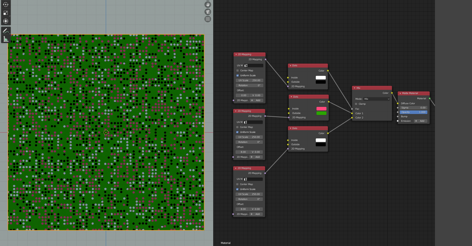

do someone know the way to dot texture in luxcore more random and also uniform or make dot smaller.
Re: BlendLuxCore Development
AFAIK the dot texture has no parameters besides the colors and the mapping, making its usecases very limited.
Posts: 437
Don't know exactly what you want, maybe you can do something like this. Note the offsets in the lower 2 mapping nodes. Color to illustrate how it works.
It seems to not quit work as for some reason the dots in a regular texture are not all perfectly aligned. you can see that some of the white dots have red/black corners
Posts: 3101
Thanks for the reply. Yes this is what i get currently with dot. But my purpose is to use dot texture for flakes layer in a carpaint shader.
I know the cycles voronoi cells texture work great.
