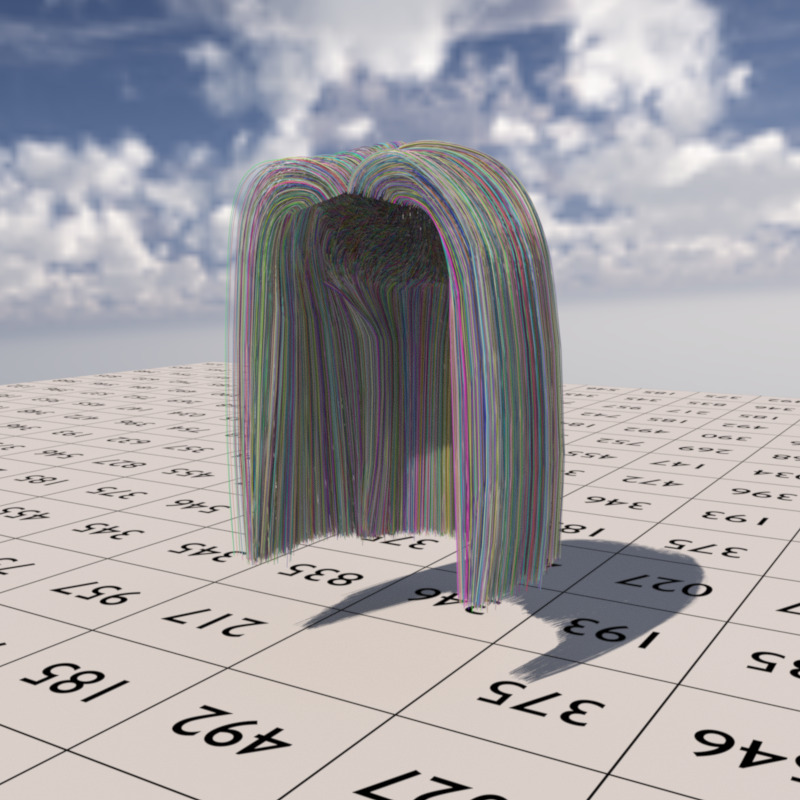

New shape "islandaov"
The new shape "islandaov" assigns, to a triangle AOV, the index of the "island", for instance:
scene.shapes.hair_shape.type = strands
scene.shapes.hair_shape.file = scenes/strands/straight.hair
scene.shapes.hair_shape.tessellation.type = solidadaptive
scene.shapes.hair_shape.tessellation.solid.sidecount = 8
scene.shapes.hair_shape.tessellation.adaptive.maxdepth = 32
scene.shapes.hair_shape.tessellation.adaptive.error = 0.025
scene.shapes.hair_shape_aov.type = islandaov
scene.shapes.hair_shape_aov.source = hair_shape
scene.shapes.hair_shape_aov.dataindex = 0
Assign island information to the hair mesh coming from a strand file.
New shape "randomtriangleaov"
The new shape "randomtriangleaov" can add/replace the triangle AOV with a randomized value, for instance:
scene.shapes.hair_shape_raov.type = randomtriangleaov
scene.shapes.hair_shape_raov.source = hair_shape_aov
scene.shapes.hair_shape_raov.srcdataindex = 0
scene.shapes.hair_shape_raov.dstdataindex = 0
This is a faster solution than using "random" texture because the value is baked at pre-processing stage.
