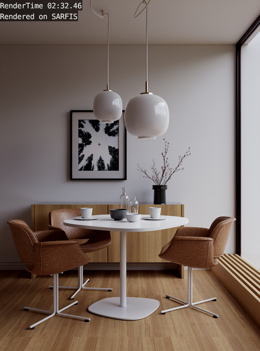

Re: Weird behaviour... GPU faster than CPU when it should not...
Post by LordOdin »
Running this on SARFIS (64 thread xeons) it managed to get the time from nearly 7 minutes to 2.5 minutes
