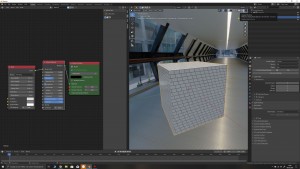

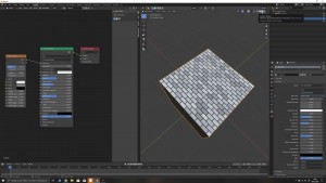

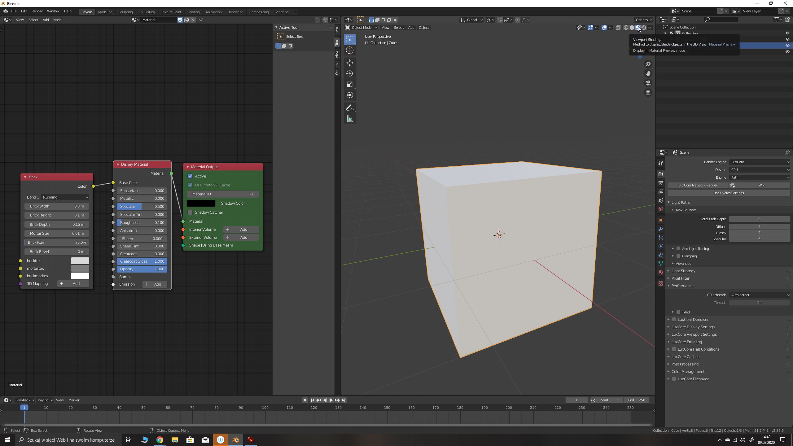

When you switch to Luxcore in Blender, material preview mode is not working at all. You can use only render preview witch is heavy. I am also hoping that will be changed asap.
Luxcore material preview
Luxcore Rendering preview
Cycles material preview
