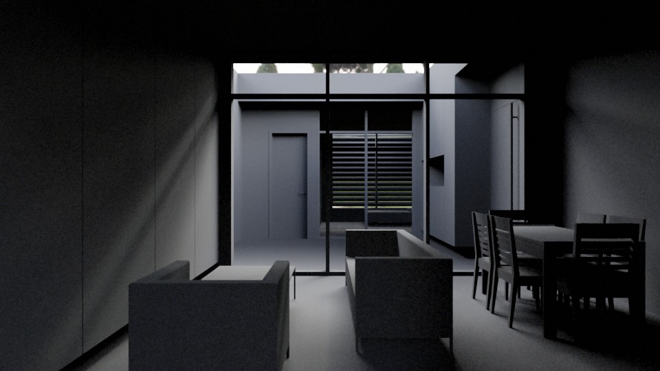

With further test i've the feeling that by using total path deph settings it is possible to bypass the n+1 behaviour.
Octane deph 1
Luxcore deph 1
Luxcore deph 2
Octane deph 2
As you can see Luxcore Deph 2 is different from deph 1. And only Octane deph look similar to luxcore deph 2 (same for deph 1 in both engine )

are those same time renderings?Sharlybg wrote: ↑Fri Jan 31, 2020 10:08 am With further test i've the feeling that by using total path deph settings it is possible to bypass the n+1 behaviour.

Not the same time. not also same quality. as you can see octane is clamping light very hard. at the same time you get this :are those same time renderings?
Octane 11sc Deph 1
Luxcore 11sc Deph 1

Interesting. Luxcore always introduces noise even in directly exposed areas, this is beyond me why it happens. How do we get noise even in the outside areas...
I think if luxcore could clamp indirect light separately from direct ligh, we might be able to get closer result... maybe...

Yes, because it actually is depth 3 and 2. They are supposed to be different.
The relevant part of the code is here: https://github.com/LuxCoreRender/BlendL ... ig.py#L276
There's also a comment explaining the reasoning.

Ok so i've removed all the incremental value. Story is the same even if luxcore get now a bit darker Octane is even darker and clamped.Yes, because it actually is depth 3 and 2. They are supposed to be different.
Octane deph 1
Luxcore deph 1
