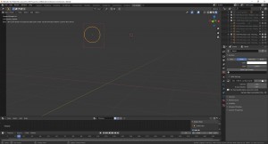

All of a sudden now when I try to get into render mode it doesn't show the HDRI I load. It has been working without any problem and it works in a default scene but in the scene, I have prepared it got bugged.
I also tried appending all the scenes into a new one and it got the HDRI running once but then the second time I switched it got bugged again. There is an error message that says "The scene doesn't include any light source (note: volume emission doesn't count for this check)" which hasn't appeared to me before.

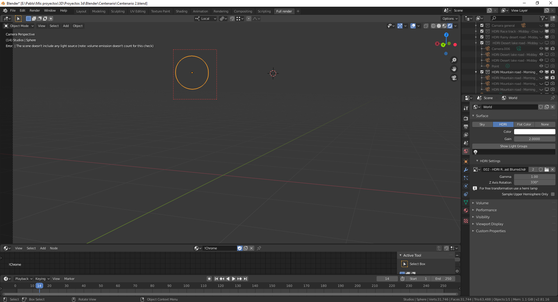

It is strange because I don't see any special characters. I'm thnking that it could be the lenght of the file path. It has 212 characters in total. Or maybe it could be this part of the file path "...HDRI's...". Might be that apostrophe? It is weird anyways because it loaded the HDRI in the default scene and in previous scene I already did.
This is another message I got just in case
World "World": 'RNA_Types' object has no attribute 'light'
And this is the error message in the console
ERROR: The scene doesn't include any light source (note: volume emission doesn't count for this check)
File "C:\Users\Ruggeac\AppData\Roaming\Blender Foundation\Blender\2.81\scripts\addons\BlendLuxCore\engine\viewport.py", line 12, in start_session
engine.session.Start()
RuntimeError: The scene doesn't include any light source (note: volume emission doesn't count for this check)

Check the full path, "C:\path\to\file.hdr", not just the "file.hdr" part. Maybe some folder has special characters in its name?PDRA wrote: Sat Jan 11, 2020 12:19 am I tried moving it to the desktop and changing its name to "test.hdr" and it seems it worked!
These are some of the names of the files I tried:
000 - HDRI Mountain road - Morning _ Afternoon - Partially clouded Blurred
002 - HDRI Rainy desert road - Midday - Overcast Blurred
Unfortunately, non-ASCII characters are known to cause problems: https://github.com/LuxCoreRender/LuxCore/issues/103
Can you upload the .blend that shows this problem?PDRA wrote: Sat Jan 11, 2020 12:19 am This is another message I got just in case
Also, are you using the latest stable release or a daily build?
