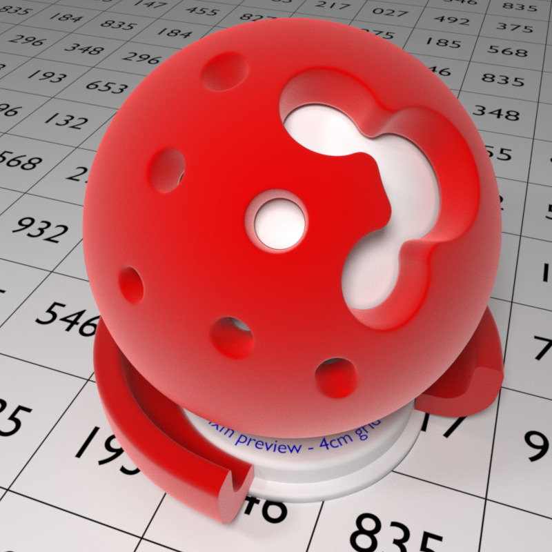

I implemented the idea. This is with a sheen value of 1.0 (the max allowed before):
scene.materials.shell.type = disney
scene.materials.shell.basecolor = 0.5 0.0 0.0
scene.materials.shell.roughness = 1.0
scene.materials.shell.sheen = 1.0
scene.materials.shell.sheentint = 0.0
And this with 10.0:
scene.materials.shell.sheen = 10.0

juangea wrote: Mon Jan 06, 2020 4:10 pm I’m not sure if 10 has to be the hard limit, but I think that’s the idea and it seems to work, I think it’s the same Lukas did for the Cycles principled shader :)
BTW, 10 was just a test, there is no limit now (i.e. at the limit you will get a totally white material).

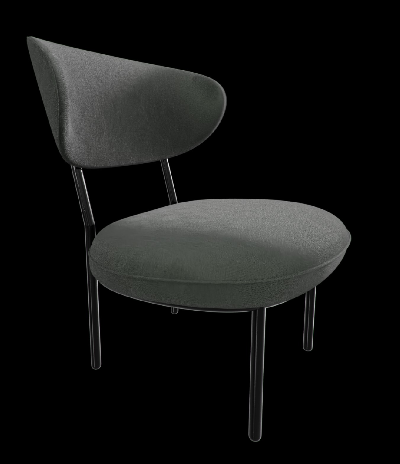

Oh man. It's working beautifuly now :shock:
aside the wonky triplanar
btw legs don't have sheen it's just reflection that makes it look like the outline is glowing :D
