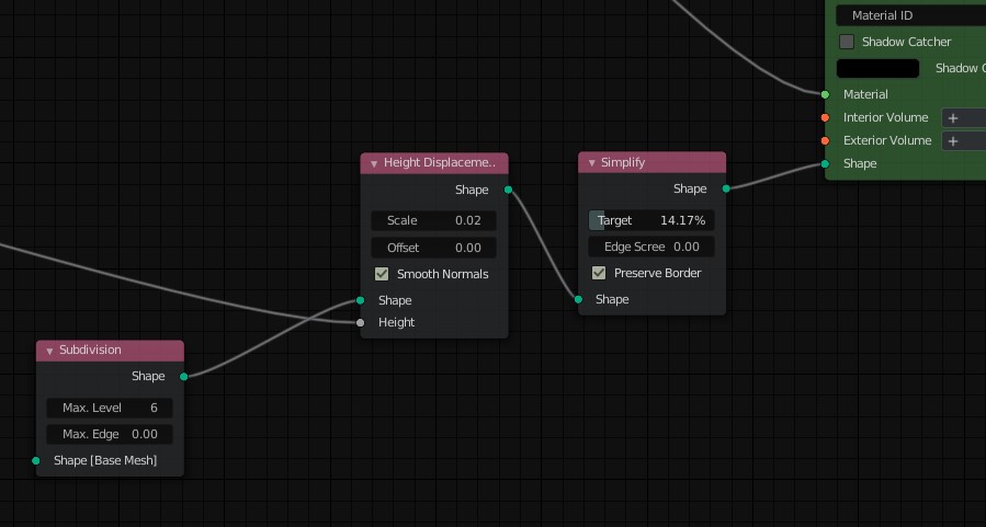

I have few questions
is this correct order of nodes to have mesh subdivided->displaced->simplified?
How does the edge screen size value work? Default is at 0.00 so does that mean that by default is the feature disabled? Or is it disabled when it's at 1?
Posts: 5672
Re: Simplify shape
lacilaci wrote: Wed Jan 01, 2020 8:56 am is this correct order of nodes to have mesh subdivided->displaced->simplified?
Yes.
lacilaci wrote: Wed Jan 01, 2020 8:56 am How does the edge screen size value work? Default is at 0.00 so does that mean that by default is the feature disabled? Or is it disabled when it's at 1?
Yes, 0.0 means disabled and it is the target maximum percentage of edge screen size: 0.1 => 10% screen size.
