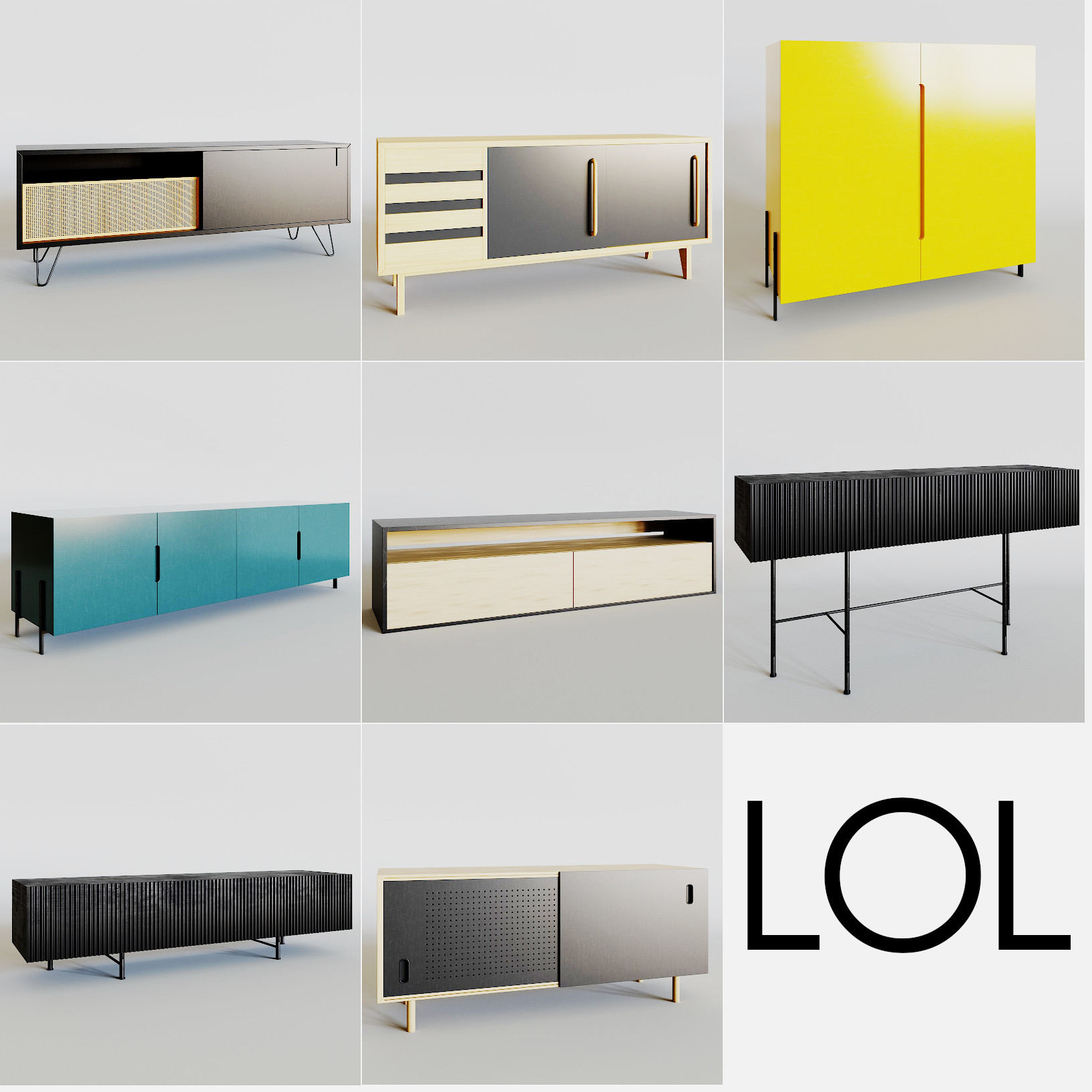

Post by Sharlybg » Fri Jul 03, 2020 5:29 pm
New furniture category are in they way to the LOL library. Patron only assets !
