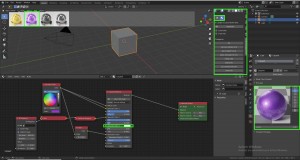

Sharlybg wrote: Thu Apr 16, 2020 6:47 pm Thanks for the reply. Yes this is what i get currently with dot. But my purpose is to use dot texture for flakes layer in a carpaint shader.
I know the cycles voronoi cells texture work great.
Recently, I've been working on the carpaint material of arnold, which has the flakes function, which is similar to the picture you sent. emm... I want to get your shader or blender file to learn how to implement similar functions in luxcore.
Posts: 3101
Re: BlendLuxCore Development
Maybe you don't know but you already have it :
just press N in viewport to enable N-Panel and from the panel go to luxcore online library (i assume that engine is set to Luxcore).
From the Luxcoreonlinelibrary select material icon down in category MISC(4) select the purple ball to assign it to anything you have in the 3D view.
As there is a small error (need update , in fact the specular 3 chanel shouldn't be connected to the constant color node) on the shader:
BLEND
Carpaint.blend
(1.88 MiB) Downloaded 232 times
