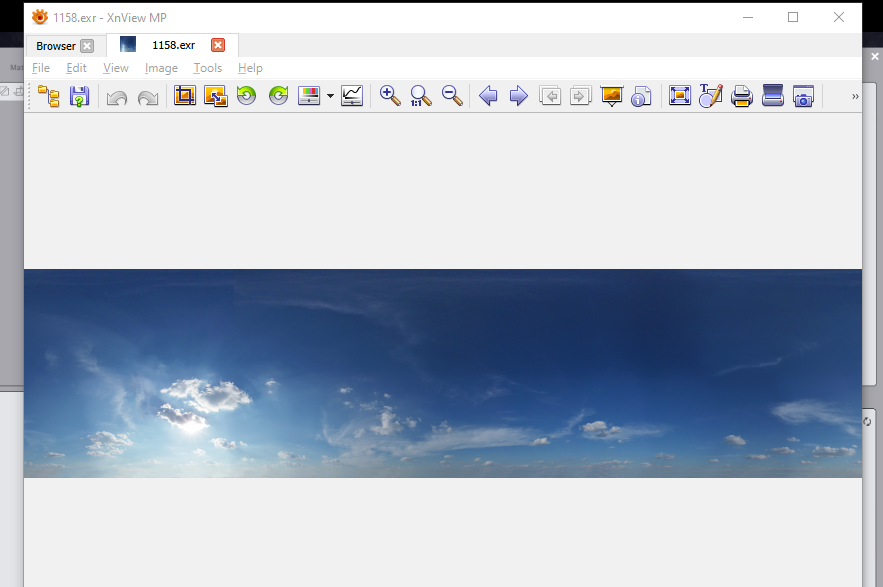

Hi Guys,
I have a HDRI image that I want to use as background. But this image is not 180 degrees in vertical but only 90.
So I want to repeat this image 2 times in vertical. Than we put a ground surface, and don't care about the sky under the ground. Is it possible to do this?

I was trying to play with transformation matrix, but it looks this scales the sphere, not the texture. I found out how to rotate the sky, but no idea how to scale it (or repeat).

bartek_zgo wrote: Mon Nov 30, 2020 12:46 pm So I want to repeat this image 2 times in vertical. Than we put a ground surface, and don't care about the sky under the ground. Is it possible to do this?
What about doing it in an image editing program? Or is memory usage a concern?
Re: Background image
This feature is requested because user are exoecting the host software to behave like that ( as it is the case with maxwell). The final goal of the app is extrem simplicity.
So for Bartek knowing where to start to have it working in this duplicating mirror way is crucial.
