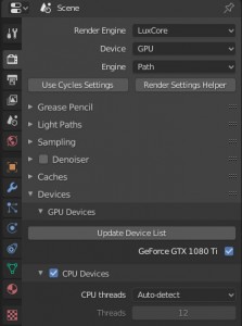

It is already the case. you just have to select your cpu when you're in GPU mode like this :

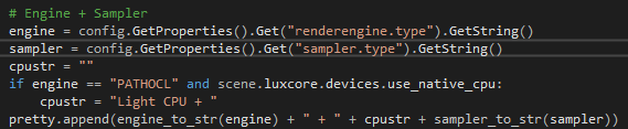

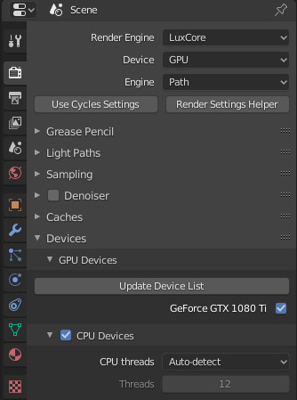

B.Y.O.B. wrote: Thu Nov 05, 2020 8:14 am The tooltip says "Use GPU(s) and optionally the CPU". Granted, nobody has time to read all the tooltips, and it's not obvious behind which tooltip the relevant information is all the time.
The info if CPU is used for light tracing could be added to the "pretty" string like in the image below :?:
