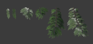

CEROE
Posts: 54
Joined: Wed Jan 09, 2019 11:34 pm
Re: TwoSided material
Post by CEROE »
There are a couple issues:
The backside seems to be extra glossy. I have tried the same settings for each, and the backside is different.
When mirroring a twig the faces are also switching.
