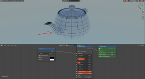

There is something wrong with this implementation, when hiding the planar edges the rendering takes twice as long and the model has the wrong wireframe, as shown below.
What I imagined was that the diagonal lines would disappear, leaving only squares.
planar hide enabled
hide planar disabled

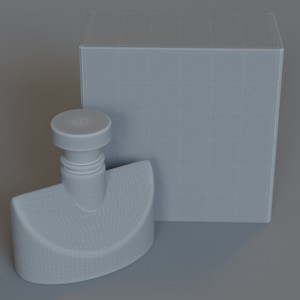

Hello Dade, so as I am an end user, I will try to explain the need for wireframe. A customer asks us for a 3d model of a product, when we deliver it is part of the sales pitch to prove that it is not a photo, although it looks a lot like one. Then we show the wireframe and the client then realizes that that ultra-realistic photo is actually CGI, that values the work.
Well, as I used 3ds Max + Corona, creating a quad wireframe shader, without triangulations, is very simple. I expected to find something similar in Blender. I am in love with Luxcore, a great defender of him in Brazilian 3d groups, but some things need to be adjusted and the wireframe is one of them. Luxcore is perfect for Archviz and Packshot products, mainly because of its glass and caustics.
Following images of the tests.

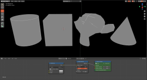

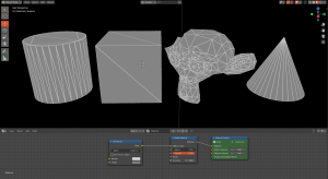

We can see that in more complex models the hide planar wireframe does not work well, if applying shade smooth then it makes everything worse.
wireframe hide planar off
wireframe hide planar on
shade smooth all objects
Regards,
Juliano Lisboa

You should post also how you would like it to look because, for what I see, "wireframe hide planar on" works exactly how is expected to work.

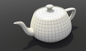

Everything OK my friend. here's an example of what you would like if possible.
And in the corona I can add shade smooth and Subdivision surface that will be right. What I can't do at Luxcore.
Luxcore
Example
Corona Shader config
