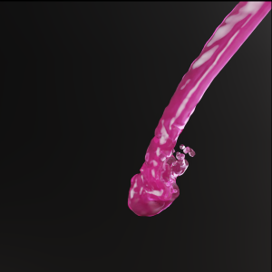

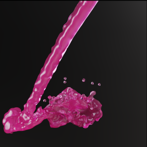

Hi guys!
Testing BlendLuxCore an I like what I'm getting.
Now I'm testing a scene of syrup pouring into glass with cocktail and ice.
Liquids are pre-meshed in RealFlow alembic mesh cache and imported as mesh sequence into Blender.
I'm having trouble of getting no deformation motion blur on imported alembic mesh with velocity data (from RealFlow).
I'm relatively new to Blender and LuxCore and maybe here is a bit dumb question. But is there any option to have the velocity extracted from alembic file and used to get proper deformation motion blur?
Thanks in advance!
