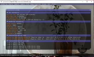

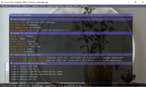

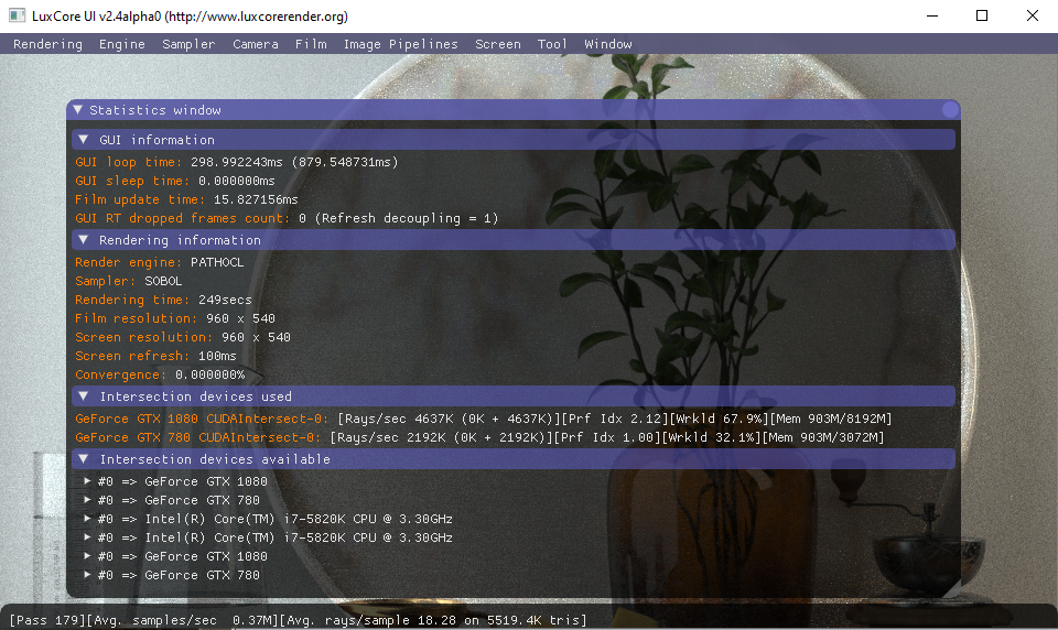

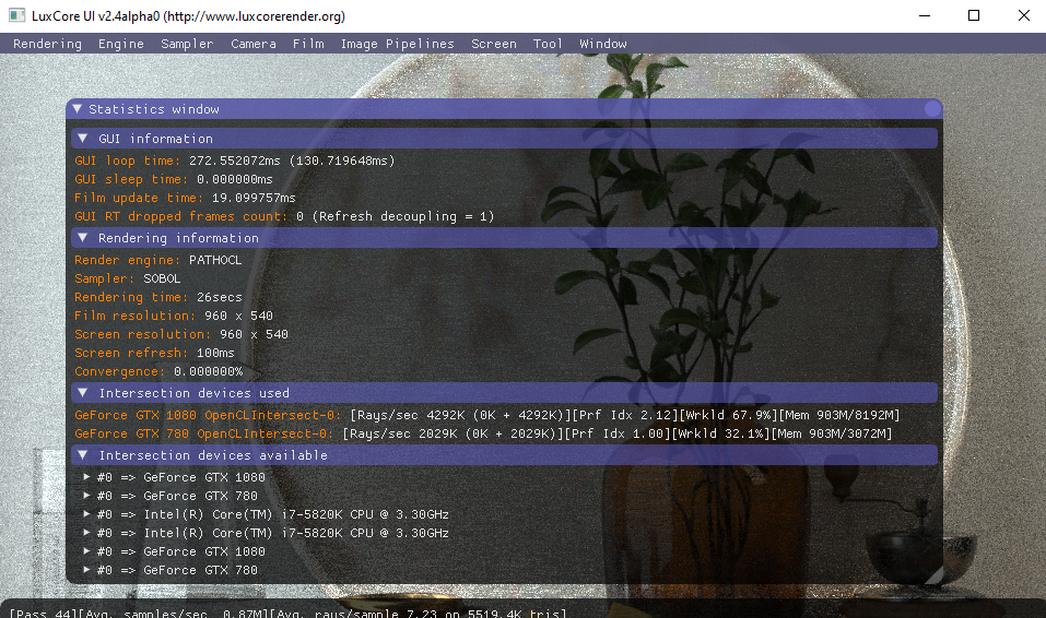

Yes, OpenCl compilation works now but I have another question. I downloaded the latest azure build and the OpenCL build is as fast/slow as my build. I see the expected speedup of cuda, too. Which is good on first sight but it is approx. 2x slower than the 2.3 build. What is the difference of the new framework compared to the old one in v2.3? Is this normal behaviour?
Food scene with LuxCoreUI v2.3:
Food scene with LuxCoreUI v2.4alpha0 OpenCL build:
Food scene with LuxCoreUI v2.4alpha0 CUDA build OCL devices:
Food scene with LuxCoreUI v2.4alpha0 CUDA build CUDA devices:

Check your screenshots: the GUI loop time is 18ms in v2.3 and 250ms in v2.4 there is something very wrong going on :?:
