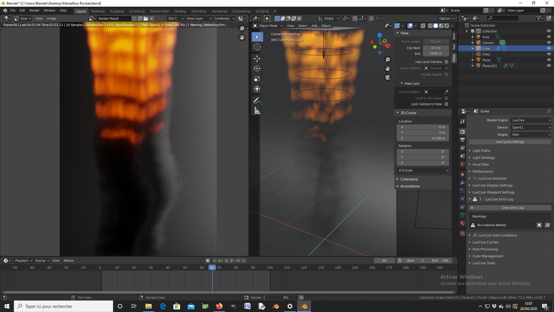

I just discover that we don't support Mantaflow while trying some smoke fire test for a tutorial . When can we expect the support from this ?

THANKS A lOT Neo2068 for the good job it work i've some test in mind for smoke :neo2068 wrote: Sat Apr 18, 2020 2:06 pm I have pushed a first fix for support of mantaflow in Blender 2.82. There are a lot of bugs in Blender still. It crashes very often.
