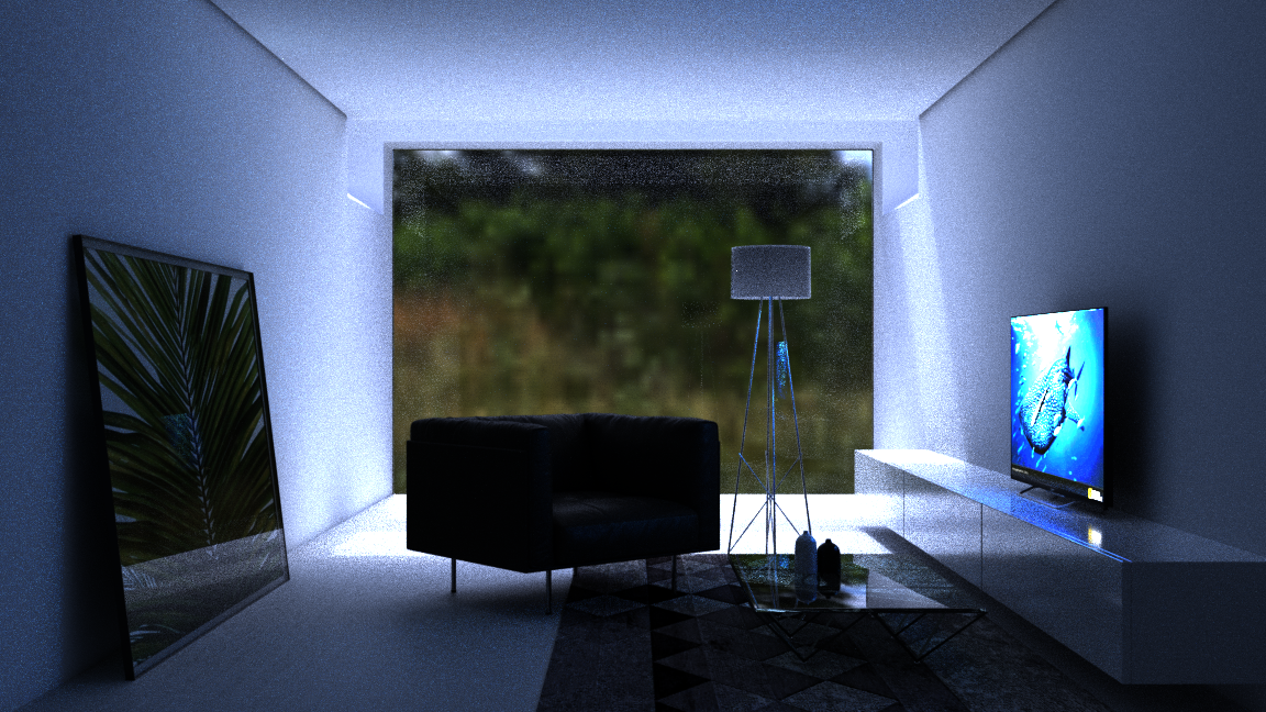

Even with the current implementation i'm a lot free compared to the compositor slow way. I can make dozens of variation in few click. It is a BOMB :D .
Sadly it save only Untonemapped file. :oops:
Posts: 3101
Re: BlendLuxCore: Save image while render is paused
All that in less than a minute :
Just few click.
