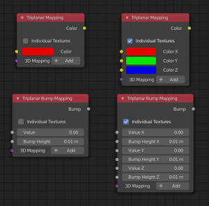

This is how it looks now.
Good? Did I forget something?
(You'll have to delete old triplanar nodes and add new ones instead because I renamed some sockets)

B.Y.O.B. wrote: Thu Jan 16, 2020 1:45 am This is how it looks now.
hm. looks ok.

juangea
Posts: 332
Post by juangea »
Looks good to me :)
Better and more clear workflow, no entangled node network required for mapping, easy understanding :)
Thinking about the text, I would out more "multiple textures" or "multiple input" instead of "individual textures", "individual" word drives me to think about it as single one, it’s a minor thing and a totally subjective thing, so it’s not important if you don’t agree and don’t change it, it’s just what I felt when I saw the nodes for the first time :)

juangea wrote: Thu Jan 16, 2020 9:02 am Thinking about the text, I would out more "multiple textures" or "multiple input" instead of "individual textures"
Sounds better, changed.
It may be a good idea to clarify somewhere (description may be) that one requires UV while the other don't :idea:
