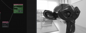

subdivision shape does this weird thing where some vertices remain sharp.. Some parts of the monkey are nicely subdivided and smoothed while some remain sharp, why is that?
hmm, it seems it depends on camera angle, so this is the keep sharp borders option I assume...
I'd like to know if it's faster to use blender's subdivision surfaces or use the shape node, also which would use less memory. Or maybe there isn't any difference?
Maybe it would be nice to have the subdivision shape being used together with simplify shape and have it as a rendertime adaptive subdivision surface instead of blender's uniform subdivisions? Is the simplify shape taking into account distance from camera?
Re: (Open)Subdiv and Displacement shapes
I would say, use LuxCore subdivision if you are going to use displacement (and may be simplify) otherwise use Blender. There isn't really a reason to leave subdivision to LuxCore if you aren't going to use some other feature.lacilaci wrote: Wed Jan 01, 2020 9:07 am I'd like to know if it's faster to use blender's subdivision surfaces or use the shape node, also which would use less memory.
