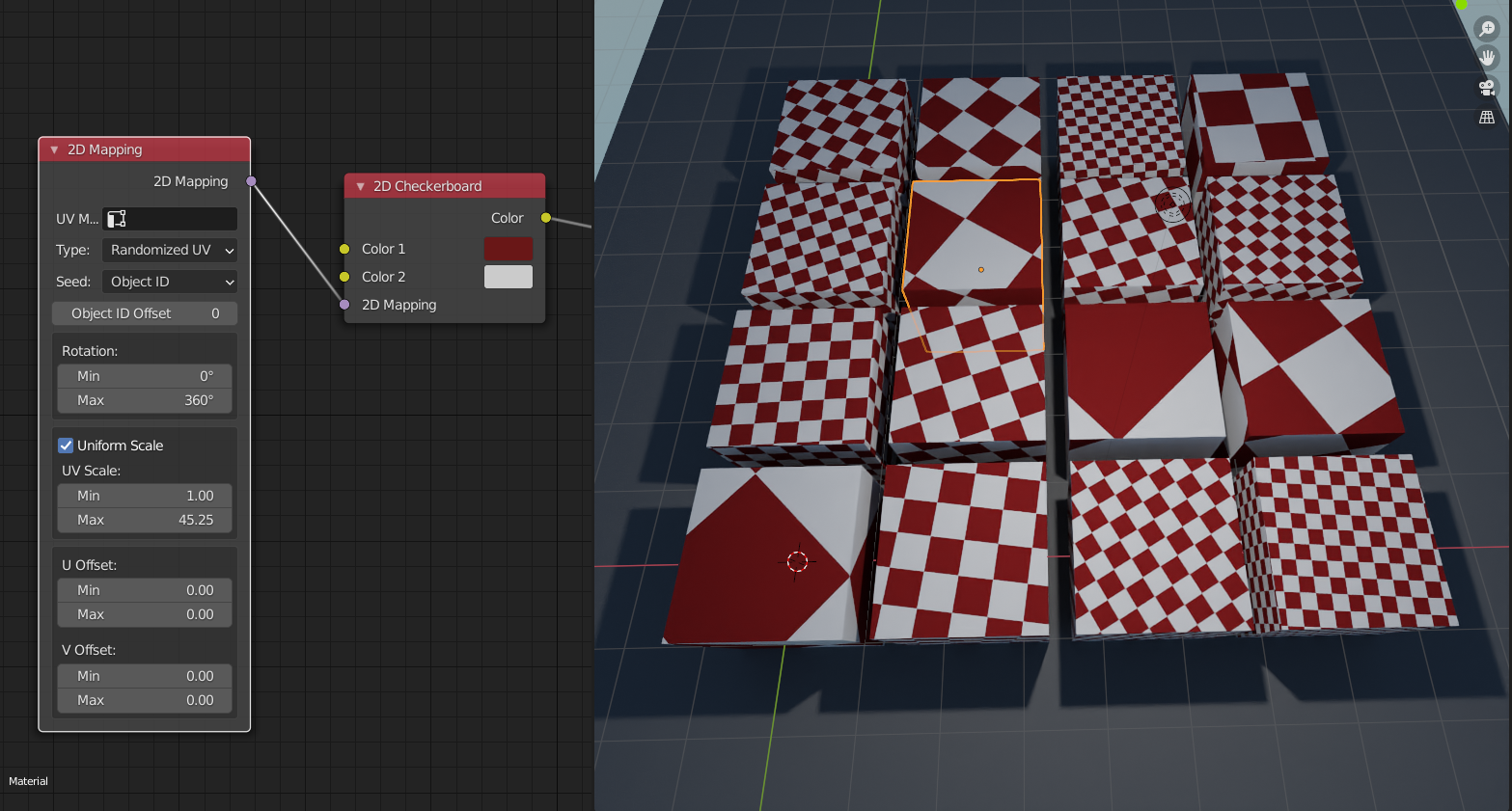

I have added support for UVRandomMapping2D to the Blender addon.
You can find it in the "Type" dropdown in the 2D mapping node.
LocalRandomMapping3D still to do.
random_uv.blend
(883.41 KiB) Downloaded 411 times

Woooohooo! That's awesome. I'm sure that I'm not the only one who will appreciate this. With that checked off of the list, the bevel shader is the last position that would enable me to transfer my projects to Luxcore. But this is a huge step in that direction.
Thanks, man.

Works like a charm. Together with the Triplanar Mapping node this beats Cycles in usability. Awesome - Thanks again.
