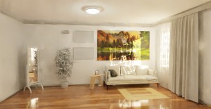

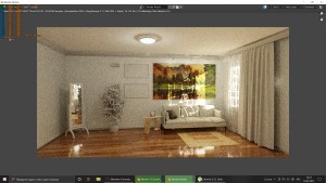

here we go:

That's just a screenshot so we can only assume how the un-denoised, final rendering looks like. But i guess it will not be much cleaner with this one being almost done. Try to get more samples in and find some way to reduce noise.
You can also manually copy the OIDN 1.3 files. It's supposed to be better. Take a look here ... viewtopic.php?f=5&t=3153

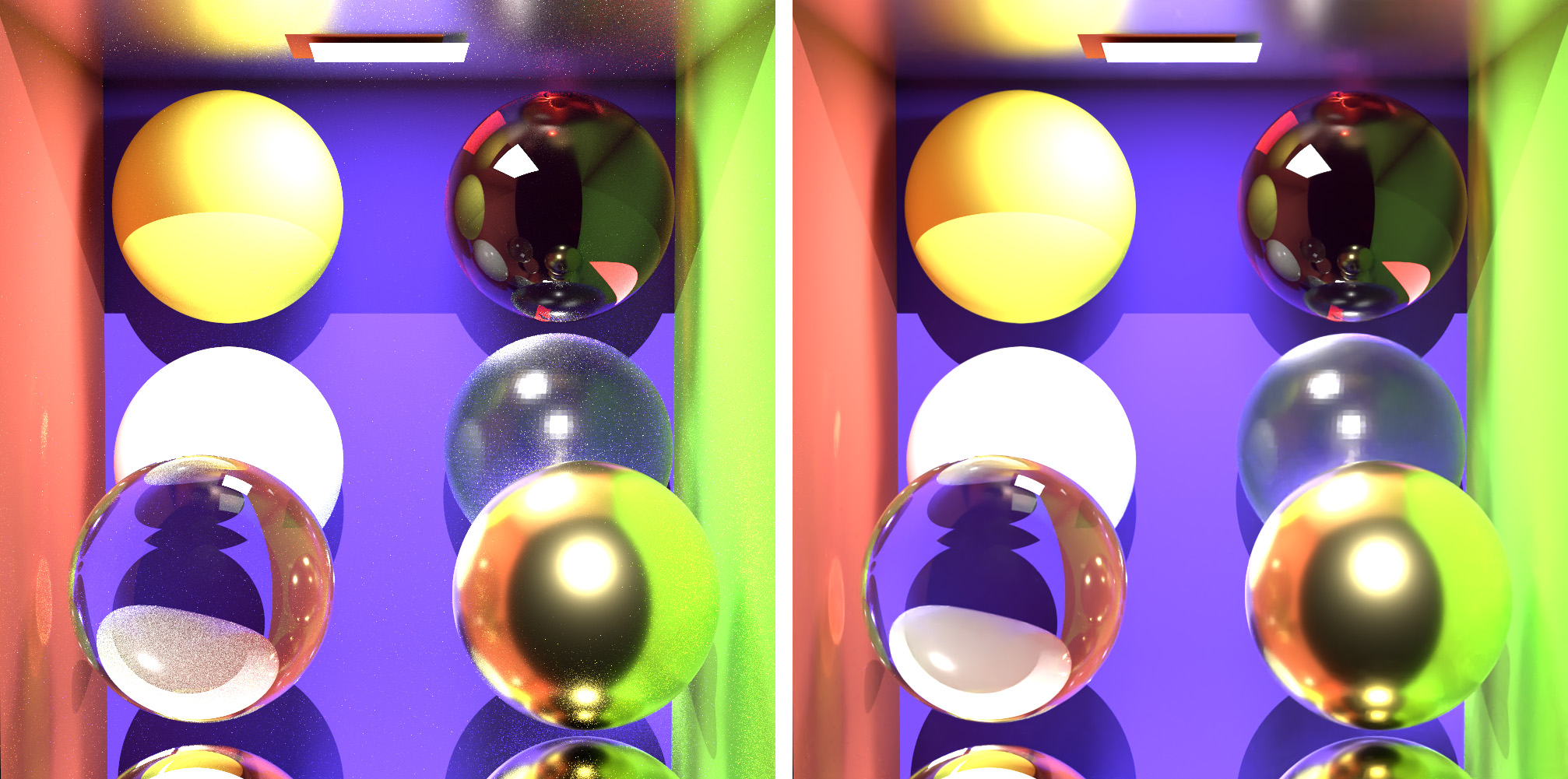

This is a nice example for a side-by-side comparison (your test scene from the initial post). And as you can see, the denoiser works pretty well.

Eltorro313 wrote: Thu Mar 18, 2021 3:59 pmhere we go:
When the input is so noisy, the denoiser just can't work miracles.
You should try first to reduce the noise further. Try the render settings helper button in the top of the render properties, it will lead you step-by-step to good settings for your scene.
If the noise level is still too high with those settings, you will just have to render more samples.

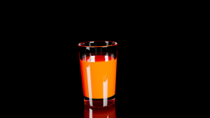

YEP, now i figured out, than for LuxCore needed many many sumples, no less then 1000
attached render 2000 samples
