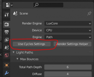

Also, pay attention to Error reports in Blender Render Properties and other helpful signs for better use.
Then you'll see and can simply press "Use Cycles Settings" but do note: pay further attention to details, not every Cycles feature and setting is supported in LuxCore. For those you will need to come up with workarounds.

Re: Why is my Luxcore render look white?
You're probably looking for this button:
