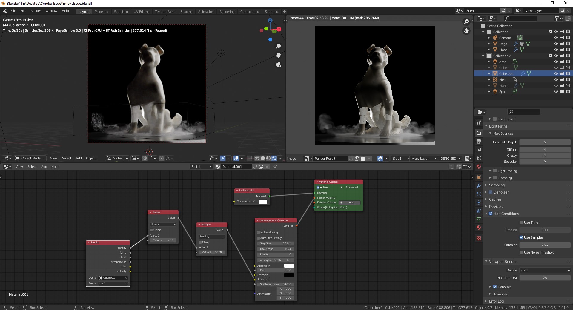

and it wasn't before (the posted scene doesn't include smoke data so I'm using an homogeneous volume both cases).
What kind of result do you get ?
I'm still on last automatic build (4 days ago)
And problem still there, see pics - with heterogeneous and homogeneous effect are the same.
Try to bake a few frames in smoke domain data (even 5 would be enough) to get some defined density for heterogeneous volume.
