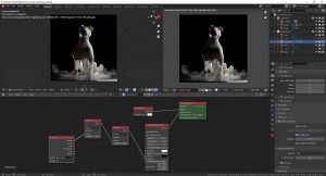

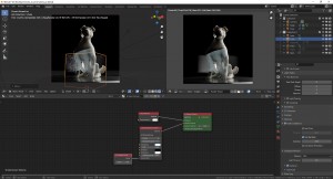

Post by DionXein »
Dade wrote: Tue Dec 01, 2020 1:47 pm It is working fine here:
and it wasn't before (the posted scene doesn't include smoke data so I'm using an homogeneous volume both cases).
What kind of result do you get ?
I'm still on last automatic build (4 days ago)
And problem still there, see pics - with heterogeneous and homogeneous effect are the same.
Try to bake a few frames in smoke domain data (even 5 would be enough) to get some defined density for heterogeneous volume.

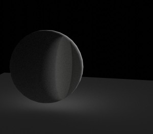

B.Y.O.B. wrote: Sun Dec 06, 2020 3:26 pm It sounds like the best course of action would be to remove the opacity/transparency socket completely from these materials.
I did this, but then it occured to me that it actually might not be a good idea.
The problem can just as well be produced by using a non-transmissive material with lowered opacity, e.g. matte with 80% opacity:
It seems to me like it is actually a problem created from combining multiple volumes with partially transparent materials.
Note: transmissive materials with lowered opacity are used in the "Canelle et Fromage" scene on the marble plate in the background, and on the cheese. No artifacts show up in these cases as long as only a single interior volume is used for each material.
I'll have to check if I can detect possibly artifact-prone volume setups during export and show a warning.
