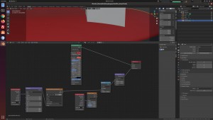

Oooookkay, now I'm really confused.
I thought this is the bump workflow:
And I thought this is vertex displacement which is not in the sample scene:
Where did I set vertex displacement in the sample scene and what is the correct way to do a bump?
Thanks, I appreciate your help.
Re: Where the bump gets strange

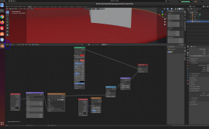

mischterlampe wrote: Fri Nov 20, 2020 11:03 am And I thought this is vertex displacement which is not in the sample scene:
It is:

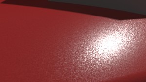

You need to adjust your the material bump sampling distance. This is a render with the default value of 0.001:
And this is the same exact scene with a value of 0.00001:
"A picture is worth a thousand words"
@B.Y.O.B, is the the material ".bumpsamplingdistance" parameter exposed in BlendLuxCore ?
P.S. changing this parameter is not required for image based bump mapping because the sampling distance is always 1 pixel in this case.
