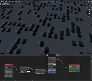

I tried to reacreate a bump, which was done in cycles. I needed a procedural noise, which is very small. I tried it with lux and it looked very strange. I invested some hours and that is the excerpt of it.
I used a procedural dot-texture. With normal scaling everything looks like it should.
Black shadow on the right, light on the left. Reminds me of the Playstation 1.
But when I make the dots smaller by increasing the uv scale, the result of the bump looks strange.
Here is a zoom of it
This happens to triplanar mapped noise, too.
I think this behavior is the reason why I dont get my desired small bump, right? Is this a bug?

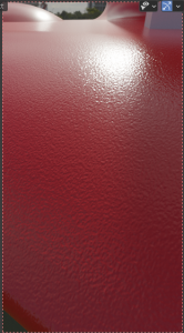

Ok, lets take the real world example.

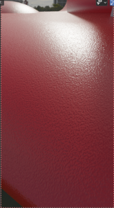

This is what cycles looks. The red cube's width is 10cm

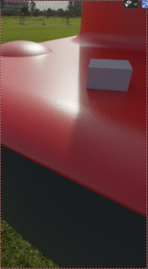

If I try to achieve this result with lux, the result looks like this. It looks weired at the bottom of the image.

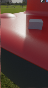

If I decrease the scale to 1000, the result looks like this, which is somehow more realistic, but not the goal

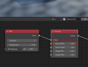

In the screenshot above you used fBM. Are you aware that this texture produces values in the range from -1 to 1? The negative values might be the cause of the problem, although I'm not sure about that. You could try to remap the values like so:
