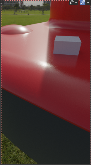

Ok, lets take the real world example.
This is what cycles looks. The red cube's width is 10cm If I try to achieve this result with lux, the result looks like this. It looks weired at the bottom of the image. Here is the shader tree, where you can see that the bump value is 0,0001 The map before the bump node looks like this If I decrease the scale to 1000, the result looks like this, which is somehow more realistic, but not the goal For me, it feels like that the bump gets broken, when the scale is too high. But if that is normal, how can I achieve the result of cycles?

No, the object is not scaled.
Here is a video where I added a sphere.
I baked the bump map from the original shader to a 16k tif and applied it to the cycles and luxcore shader to drive the bump. In cycles everything behaves like expected. The baked map and the procedural map do a good bump.
If I take the baked map into the lux shader, it results in a good bump, too. But if i try to drive the bump by a procedural map, the bump doesn't appear. I tried to get the same greyscale "image" out of the baked and procedural map, but the bump results are very different. There are different strength in the bump-node. If I would use the strength of the baked-map node tree on the procedural-map tree I wouldn't see any effect at all.
