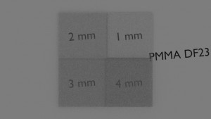

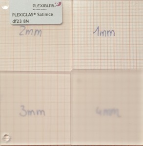

- Posts: 236
Re: strange behaviour of homogeneous scattering volume
Hello all,
I'm still working on the example file... but the topic remains in my mind and also on my desk.
I've continued the investigation of the scatter volume and all the tests I've done share also one irregularity. The render results doesn't look blurry. It always appears like there's a colour fade out only with the growth in material thickness:
This is a photo of the material that is like imitate: You see the written information blurr out with more material.
What do you think about that?
BR
That is not a property of the scattering volume, but of the surface!lighting_freak wrote: Mon Nov 23, 2020 3:46 pm I've continued the investigation of the scatter volume and all the tests I've done share also one irregularity. The render results doesn't look blurry. It always appears like there's a colour fade out only with the growth in material thickness:
You can see in the picture, and also the manufacturer says on the website, that it has a "satinated" surface.
So you need to model that. I think a normal map could be sufficient, and certainly more efficient than to model out the geometry.
Hi Lighting freak, i think that the blurriness increases not because the mayor thickness but simply because the mayor distance between the upper surface and the paper behind. Try to elevate the thinnest sample at the same elevation of the thickest one by putting some coins below it; you should get an even higher amount of blurriness.

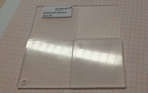

- Posts: 236
thanks for your answers.
This is current model if anyone likes to play: With best regards
On this pictures you may see that the sample plate is almost specular: Anyway I ran tests with different surface settings (rough, matte translucent, bump) and none really turns out to reach blurry appearance. In most cases the darkening comes back.CodeHD wrote: Mon Nov 23, 2020 4:20 pm That is not a property of the scattering volume, but of the surface!
The sample has a plane rear surface and the distance of the surfaces to each other is simply given by the geometry of the plate.daros wrote: Mon Nov 23, 2020 5:53 pm i think that the blurriness increases not because the mayor thickness but simply because the mayor distance between the upper surface and the paper behind
